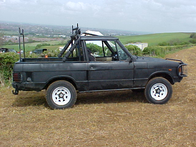

<p dir="auto"><img src="/assets/uploads/imported_images/493/Pickup1-04.jpg" alt="" class=" img-fluid img-markdown" /></p>

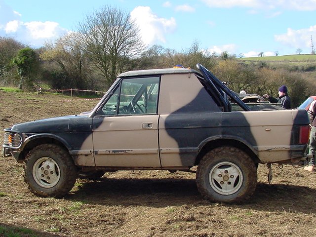

<p dir="auto"><img src="/assets/uploads/imported_images/493/Pickup5-01.jpg" alt="" class=" img-fluid img-markdown" /></p>

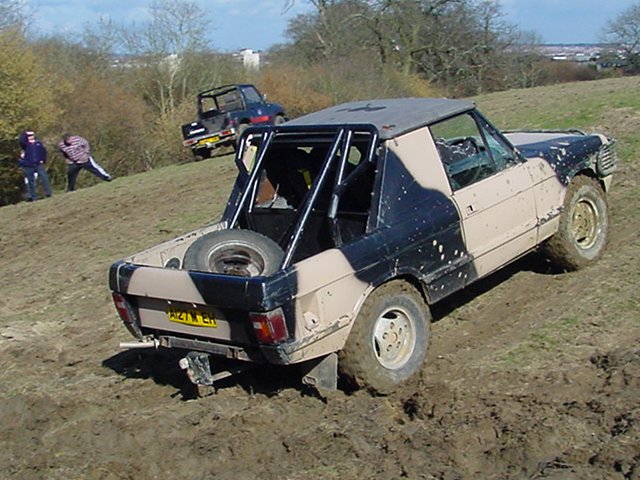

<p dir="auto"><img src="/assets/uploads/imported_images/493/Pickup8-05.jpg" alt="" class=" img-fluid img-markdown" /></p>

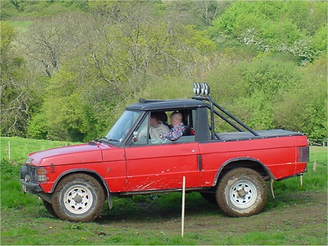

<p dir="auto"><img src="/assets/uploads/imported_images/493/Pickup09-02.jpg" alt="" class=" img-fluid img-markdown" /></p>

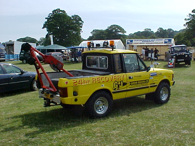

<p dir="auto"><img src="/assets/uploads/imported_images/493/Pickup09-06.jpg" alt="" class=" img-fluid img-markdown" /></p>

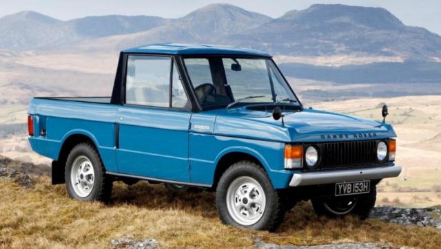

<p dir="auto"><img src="/assets/uploads/imported_images/493/Pickup3-door.jpg" alt="" class=" img-fluid img-markdown" /></p>
]]></description><link>https://jlrforum.ru/post/21034</link><guid isPermaLink="true">https://jlrforum.ru/post/21034</guid><dc:creator><![CDATA[Сергей 77]]></dc:creator><pubDate>Sun, 18 Oct 2015 07:01:00 GMT</pubDate></item><item><title><![CDATA[Reply to Кузов и рама on Sun, 18 Oct 2015 06:42:00 GMT]]></title><description><![CDATA[<blockquote>
