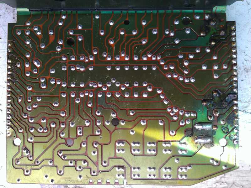

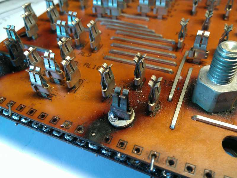

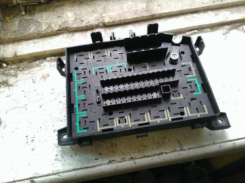

<p dir="auto"><img src="/assets/uploads/imported_images/568/WP_000738.jpg" alt="" class=" img-fluid img-markdown" /></p>
<p dir="auto"><img src="/assets/uploads/imported_images/568/WP_000728.jpg" alt="" class=" img-fluid img-markdown" /></p>
<p dir="auto">Надо сделать вот так</p>
