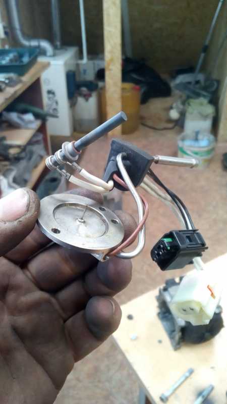

<p dir="auto"><img src="/assets/uploads/imported_images/485/IMG-57d392138450308fe23d26549c90e9bf-V.jpg" alt="" class=" img-fluid img-markdown" /></p>

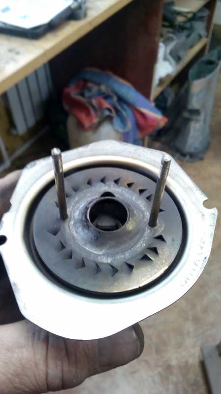

<p dir="auto"><img src="/assets/uploads/imported_images/485/IMG-451f422c016ca056332f7589bd4a983f-V.jpg" alt="" class=" img-fluid img-markdown" /></p>

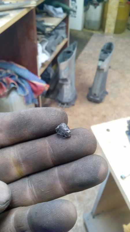

<p dir="auto"><img src="/assets/uploads/imported_images/485/IMG-08169fa52f255bdb2a4dd254589bfb28-V.jpg" alt="" class=" img-fluid img-markdown" /></p>

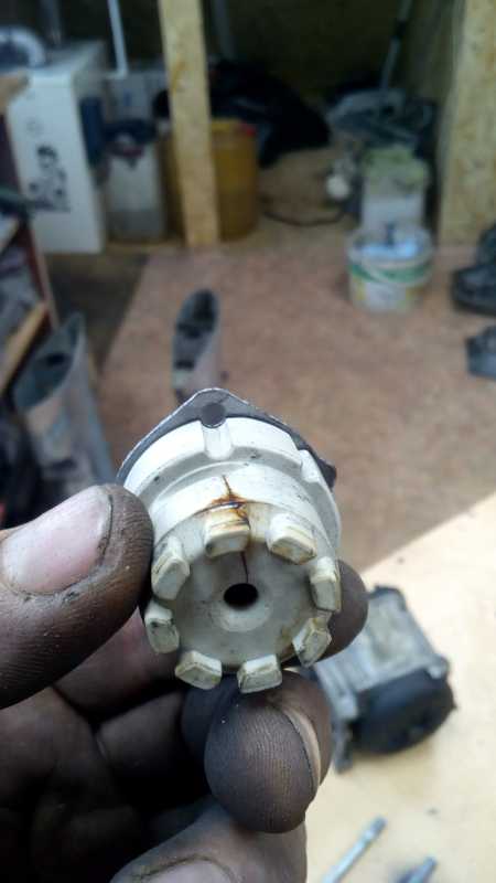

<p dir="auto"><img src="/assets/uploads/imported_images/485/IMG-fcd43797d4422664f6742b3b550ca191-V.jpg" alt="" class=" img-fluid img-markdown" /></p>

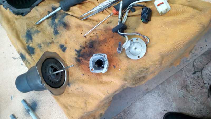

<p dir="auto"><img src="/assets/uploads/imported_images/485/IMG-fcdda230525895f90040fb89fe3fcbf7-V.jpg" alt="" class=" img-fluid img-markdown" /></p>
